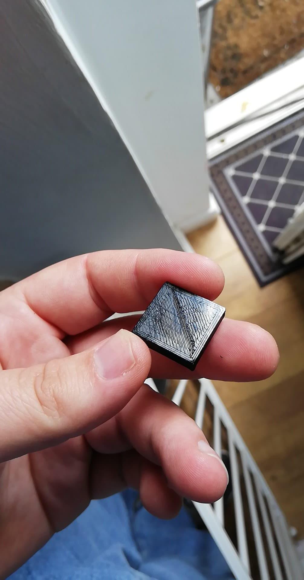

    Hey All,
    I have a Ditto Pro, on a glass bed and i use prit stick to hold the print down. I have also attached the print below. Ive had to stop useing the tinkerine suite as that was making the prints worse for some reason, ive leveled the bed like 100 times lol and still no luck, there seems to be the odd gap inbetween layers and it just generely looks pants.
    Thanks in advance
    Simon

    Hi Simon, I would take a look at the drive gear which is the bronze gear that pushes the filament through the hotend. I would check if there is any filament/powder that is stuck in the grooves. The middle line at the bottom of your print looks like a skip, how does the other walls look?
    This could be a sign that the hotend is jamming, you can also test that out by preheating the printer and then pushing filament through. Let us know if it is relatively hard or is it easy to push filament through.
