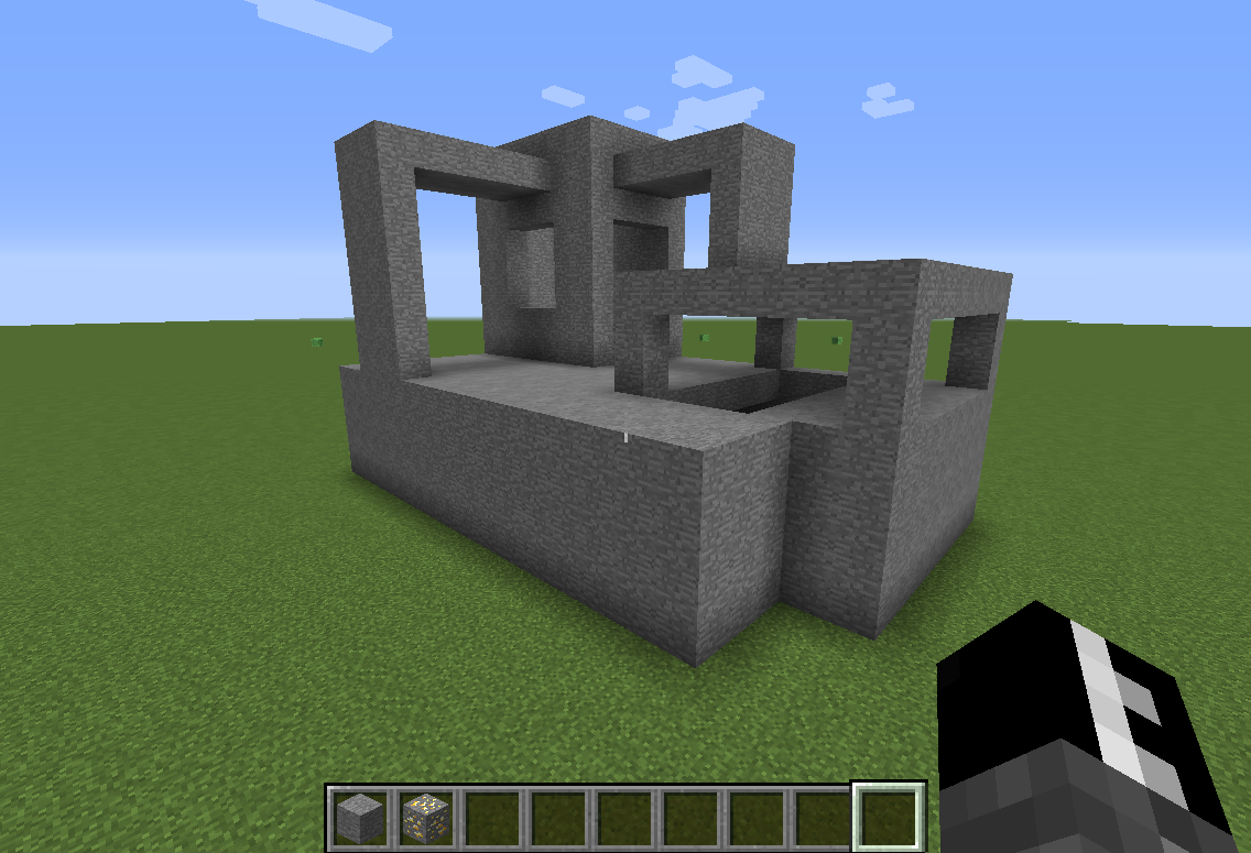

    3D printing model design constraints are the same Minecraft as in any other kind of modelling software. One of the biggest design challenges to overcome is overhang. There are many designs that I can create in Minecraft that I can not 3D print.
    For Example

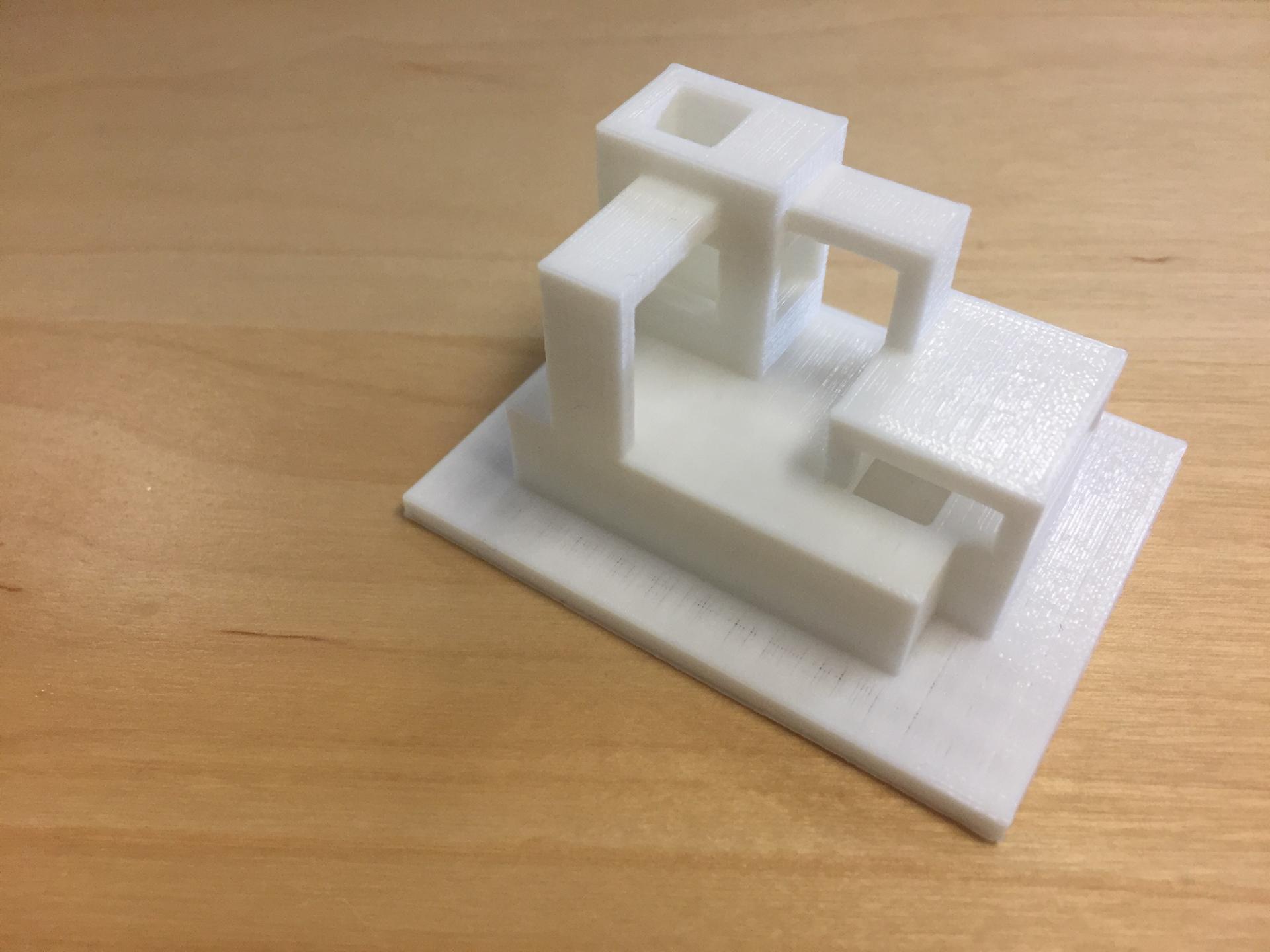

    The design on the right side is impossible to 3D print (current orientation) because it is not attached and the overhang angle is at 90 degrees. The design on the left side is possible but may fall over mid print due to the fact that the surface area that is sticking to the bed is too small. (This can be fixed with orientation)

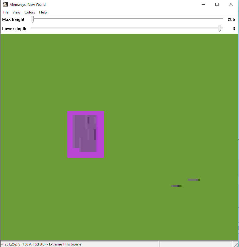

    1. Open Mineways
    2. Load the world the building is in by going to File -> Open World -> [Name of the world]
    3. Right Click and drag the area for 3D printing
    4. Export for 3D printing by going to File-> Export for 3D Printing
    5. Change "Save as type" to OBJ or STL
    6. Save file

    Results
