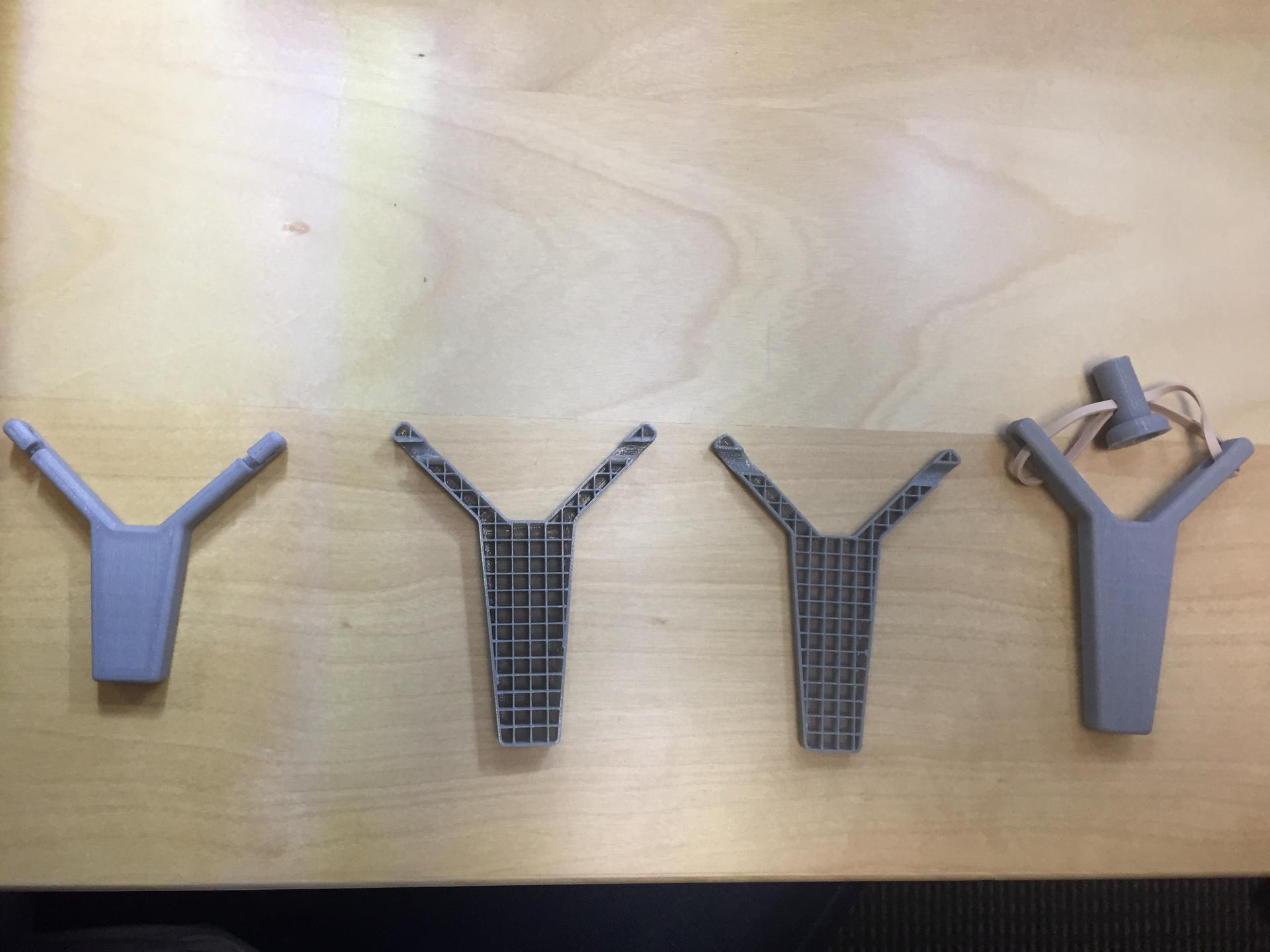

    I made a slingshot in on shape using the challenge as a guide.
    1) my first attempt caused problems because the elastic band kept falling out
    2) After redesigning my sling, I increase the length of the handle as well as enclosed the elastic band holder. There was problems because I used the pause function in Tinkerine suite, its for changing filament so it ejected my filament
    3) When using the the pause function in the DittoPro, I realised that my orientation was incorrect. This created problems because the carriage was hitting the cap i printed earlier when I went to install the elastic band.
    4) it finally worked! After making changes and improvements, I was able to create a sling shot that works!
