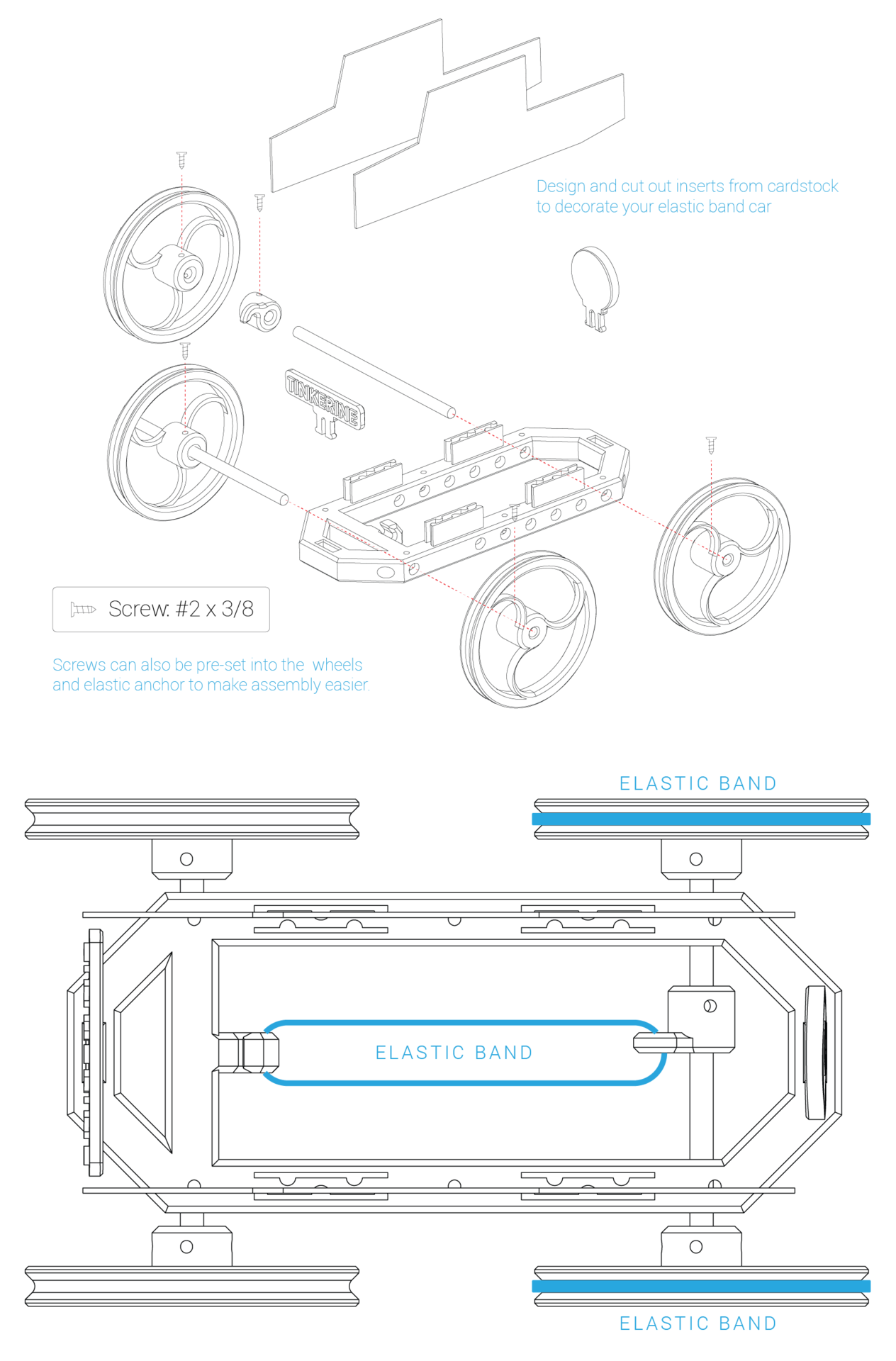

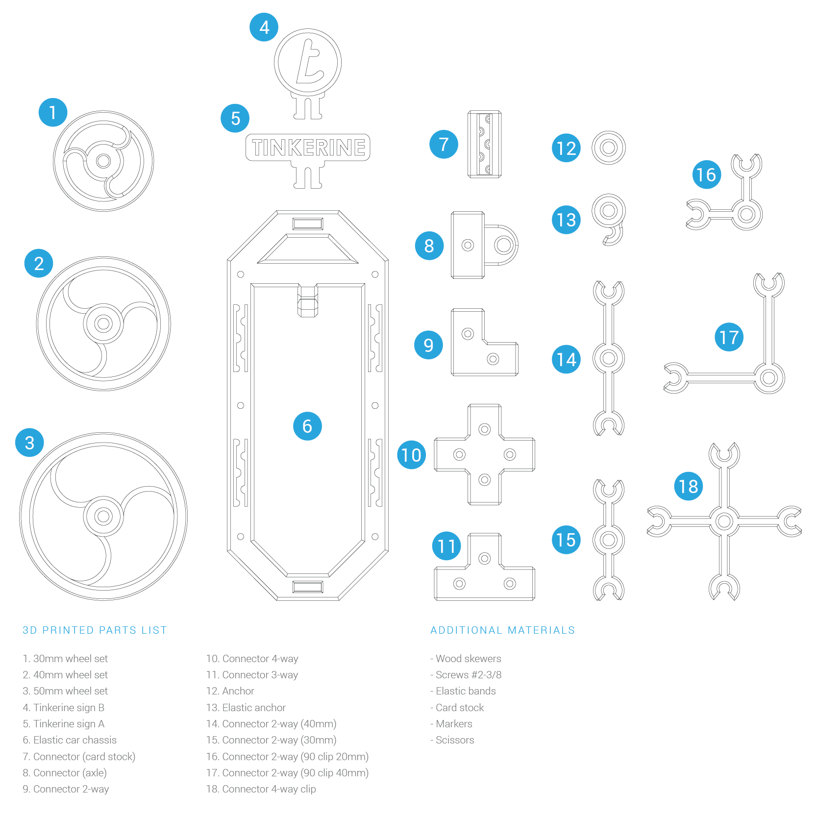

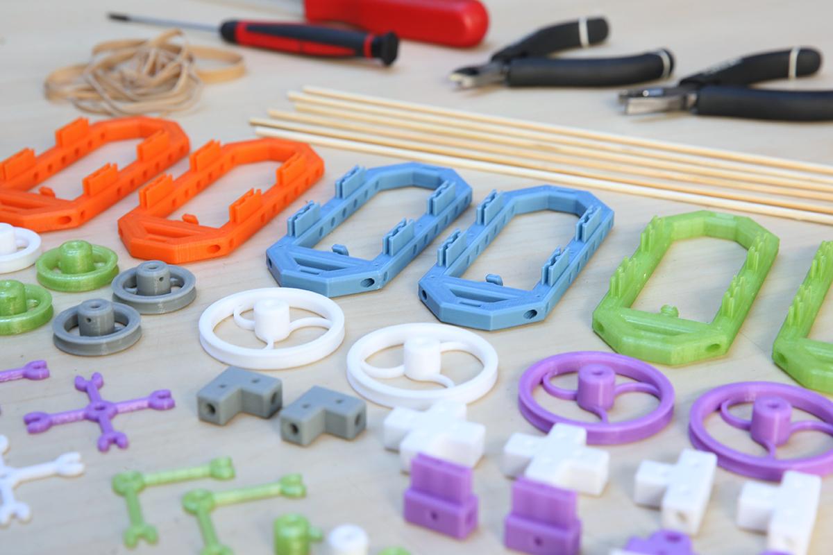

Select from a variety of connectors and wheels to add to the chassis. Printed components can be joined using wooden skewers and locked in place by screwing down #2 3/8” screws.
